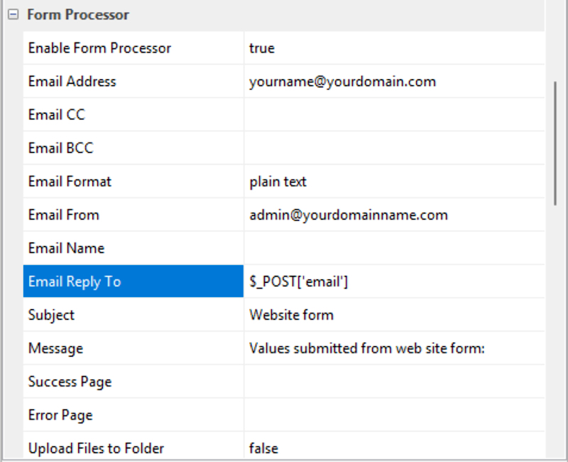

Emails are not arriving in my inbox...
1. Did the emails end up in spam?
2. Maybe the emails were blocked by your ISP (yahoo and others may block it on the mail server)
3. Does your host support PHP mail?
4. Does your host allow you to send email to the destination email address? Some hosts do not allow you to send emails outside your own domain. Try to use different email address.
You can set a fixed 'from' address in the properties of the form.
Note:
The 'From' email field will be used set the 'from' address of email sent messages to the specified email address. If you leave the field empty then either the 'email' input will be used (if it exists) or the 'to' address.
The 'From name' allows you to set the name of the sender. It is also possible to use a PHP variable. For example, S_POST[‘name’] where ‘name’ is the name of the input field.
'Reply to' can be used to specify an alternative reply address. 'Reply To' can be a fixed email address, in which case you must use quotes:
'yourname@email.com'
or a PHP variable:
$_POST['email']
5. If changing the email in the form properties address does not work then rename the 'email' editbox to 'e-mail'. This will prevent the script from using the specified email address as the 'from' address.
6. Did you insert any code at the start of the page yourself? If yes, please remove it.
7. If the form does not give an error message then there is most likely a problem on the server side. Please contact your host for further assistance.
